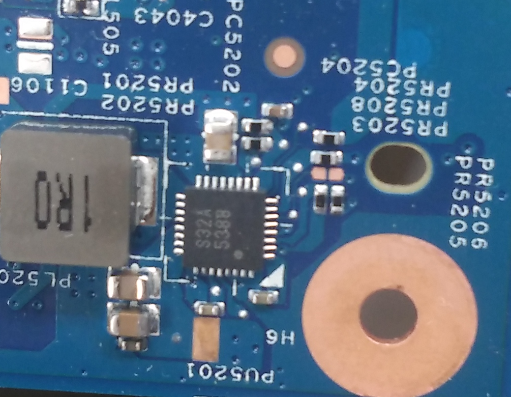

Hello, the architecture it's quite new with DDR4 on the board. After flooding. Please identify the driver / DC converter from the image.
The item repeats twice on the MB, marking:
S32A
5388
Thanks.
https://www.elvikom.pl/obrazki/_f/f_0032953.png

G5388
http://www.kingpex.com.tw/data/document ... e-2016.pdf
