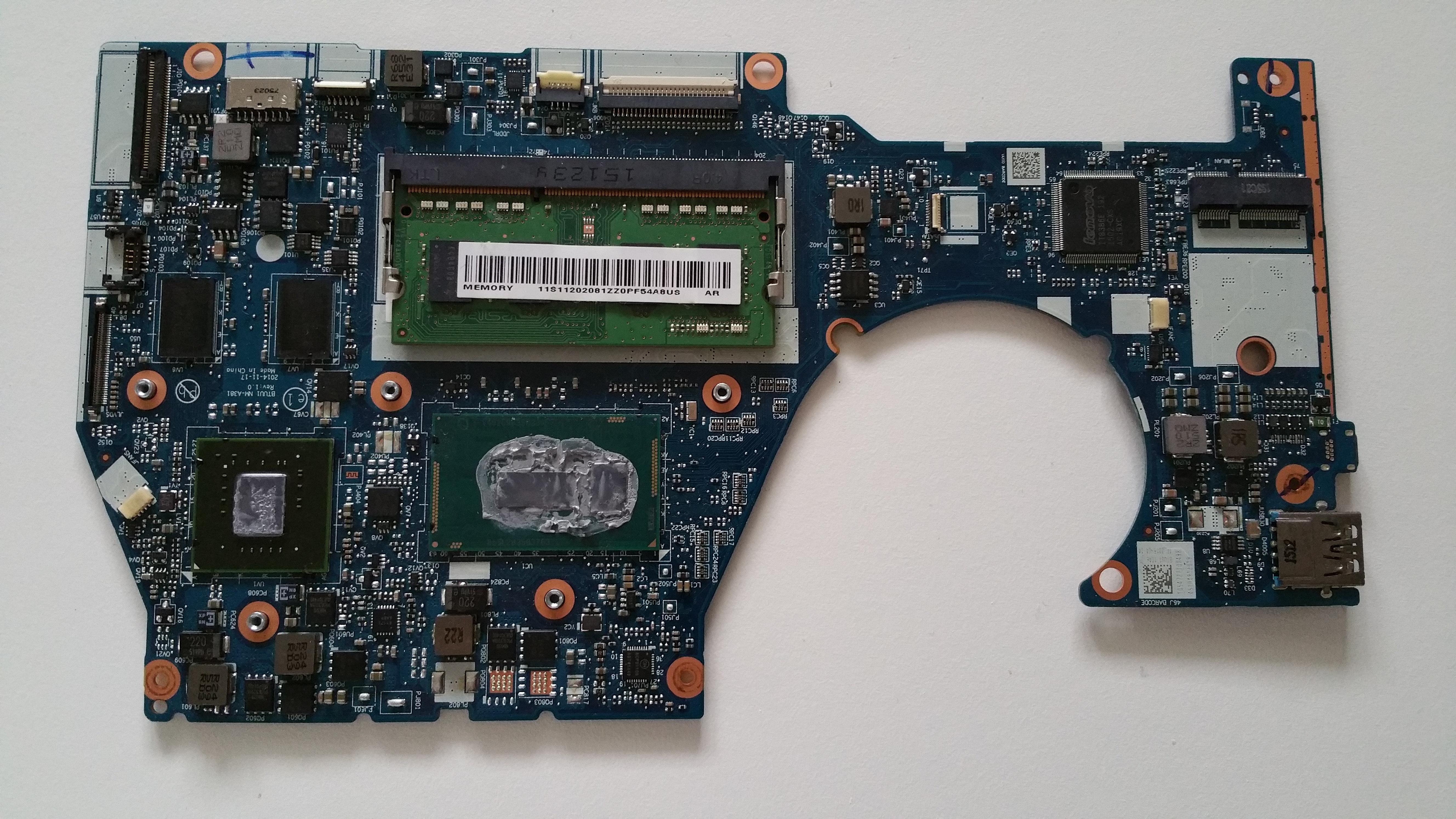

Hi
laptop start , backlight keyboard works few second , fans works normally but there's no display .
I tried other bios nothing change.
I don't have schematic can you help me please
Best regards

Hi,
TPS 51716 is hot when laptop running , so i checked voltages :
pin 6 = 1.7v
pin 8 = 1.3v
pin 11 = 5v
pin 12 = 5v
pin 15 = 0.15v
pin 16 = 3.3v
pin 17 = 3.3v
pin 18 = 1.46v
Is it right ?
Best regards

Hi ,
TPS 51716 have replaced laptop works
