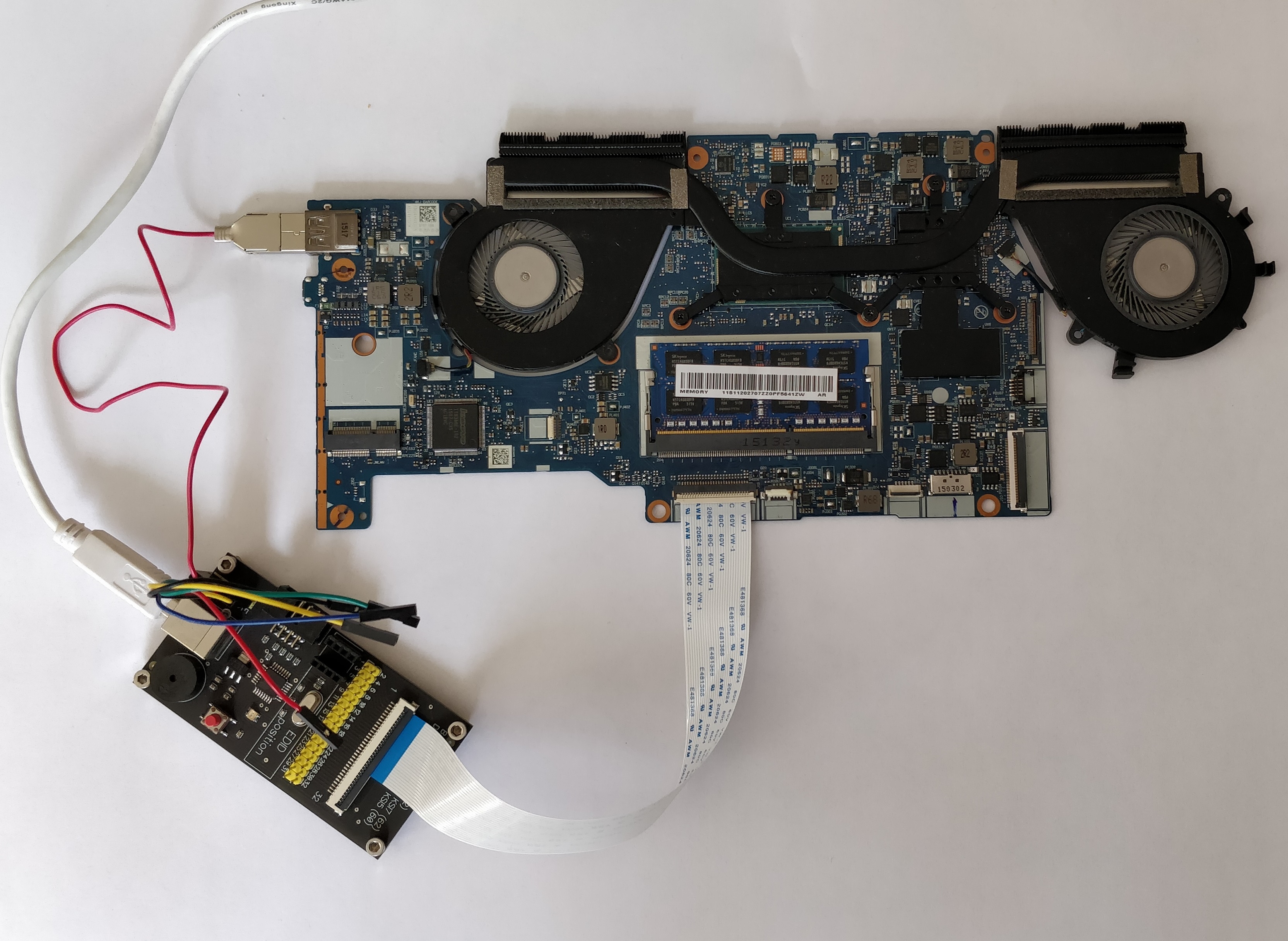

Hi ,
This motherboard doesn't start , so i found short on IT8386E
I replaced it, now laptop start but no display .
i think i must program IT
i use programmer with Vertyanov JIG ver 4.C.
When i check connection i have this message "ITE we do not respond, check the connection and settings. MB powered? (00)"
Can you tell me why ? I forgot anything ?
Best regards

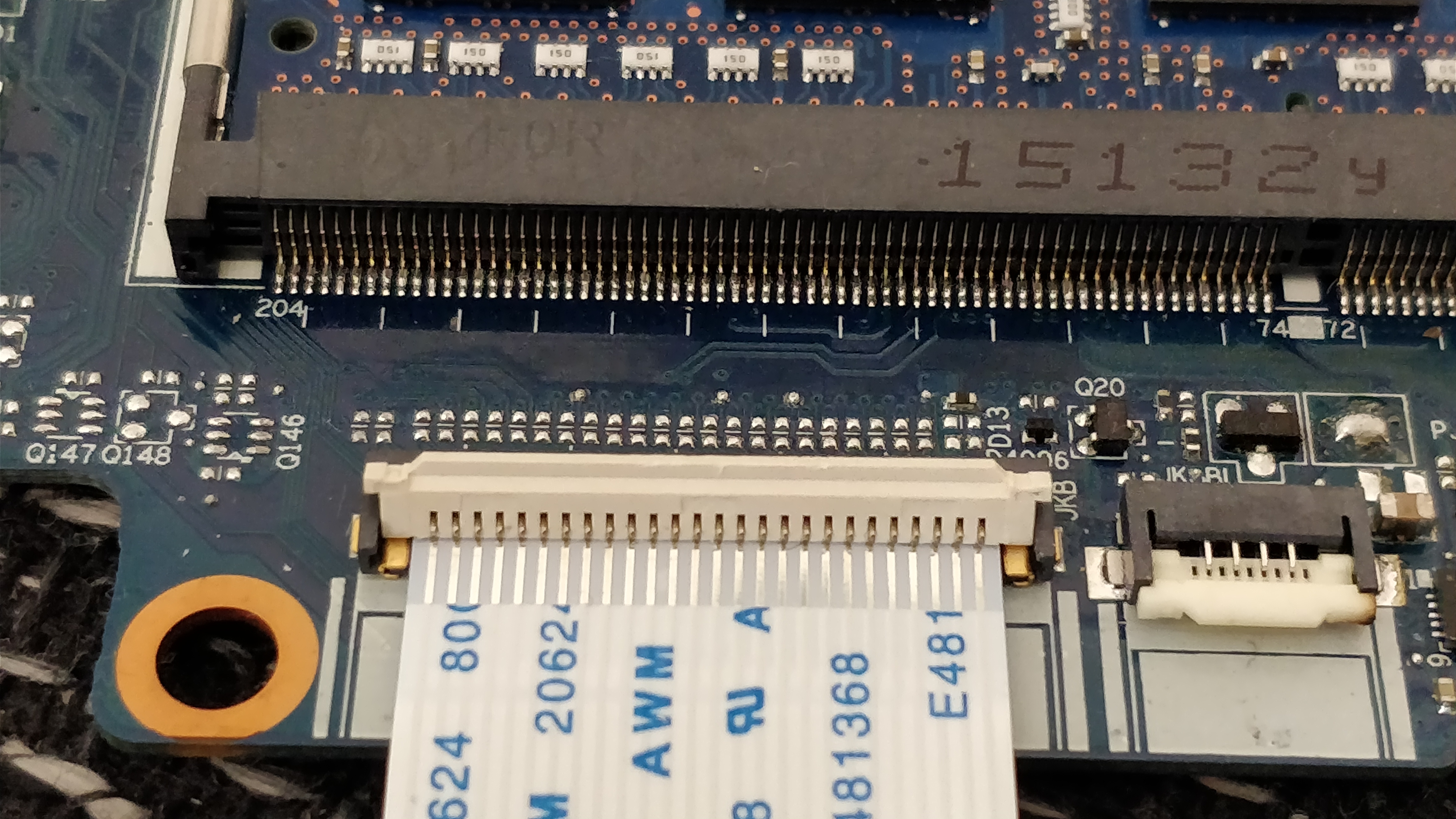

Are you sure that this step is 1mm? Not 05 or 08mm

i look it's ok
but if i turn cable for aligned pin 1 with pin 1 i lose contact on the connector.

Hi ,
i soldered wires because cable 26 pin not apply contact correctly , it don't orks so i plug motherboard and i can program
But i have other problem.
It start again without dislpay.
Motherboard start when i plug
i replace TPS51716 ; BQ715
i check some voltage :
PL301 0.540v
PJ 303 0.5v
PJ 304 0.17v
what i have to check ?
Best regards
